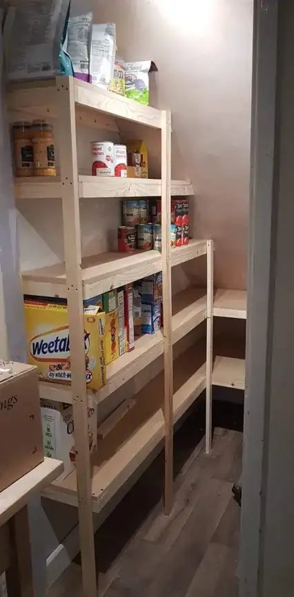

I would like to build some shelves for the cupboard under the stairs. I quite like the layout in the following picture:

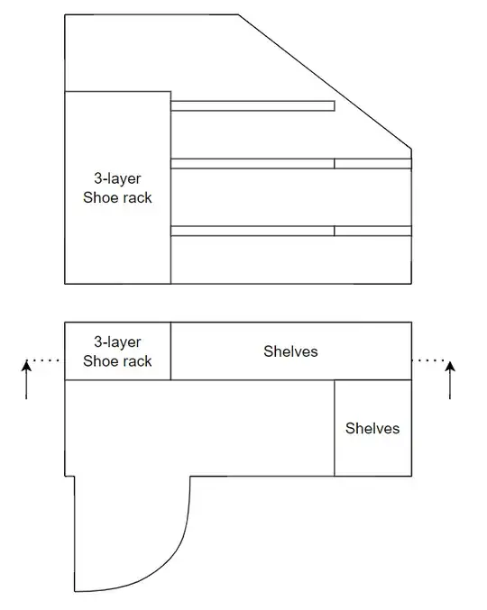

My cupboard is roughly per diagram below, were I would like to put a 3-layer shoe rack next to the shelves (the walls to the left and rear of the show rack are dot-and-dab, everything else is stud walls with metal studs.
I would like some recommendation on out to build something like this which results in level shelves. In particular:
