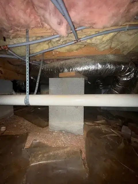

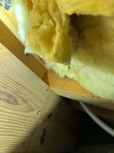

I'm looking for some tips installing a jack post. For some background, I recently purchased a house. The previous owners covered a lot of issue and ended up with a terrible home inspector which didn't help. One of the issues we found after the purchase was a sagging joist below a load bearing column/short wall (Would have to remove drywall to figure out which one it is). Bad news, somebody previously removed the support below the load bearing area. It appears they tried to sister the joist at one point but it's enough. Good news, the original pier is still there so all I need is a post. I would prefer to install a beam spanning between the existing beams but plumbing and HVAC are in the way. Current plan is as follows:
  1. Install Simpson connections at each end of the double joist to help spread the load to the beams
  2. Install jack post on existing grout filled CMU pier
  3. Possibly Wedge piece of wood between jack post and the bottom of joist to engage adjacent joists
  4. Jack up the floor joist about an 1/8 of an inch each week until the floor is level

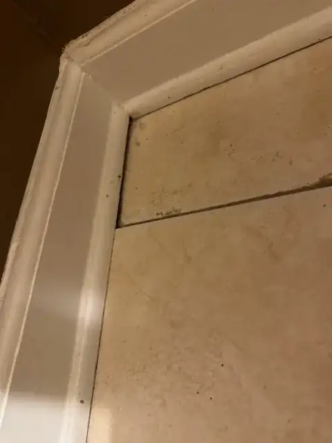

Questions are as follows. Did I miss any steps in my plan? Do I need to remove any finishes/baseboard before leveling the floor? Do I need to cut out the grout between bathroom tiles to prevent the tiles from cracking during the floor leveling? Is there a good method for locating the column from the crawlspace? I would like to make sure the column is bearing on the sagging joist directly.
