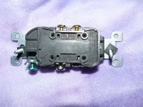

If you're talking about an outlet - or a similar concept fixture - the best tool I've found is a flat head jeweler/precision screw driver.

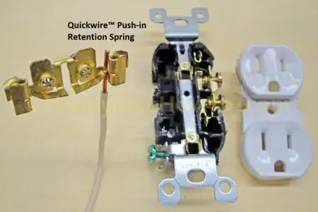

The wire is being held in by this:
You can see you'll need to push that "tab" away from the wire, from the back of the outlet you should see a small rectangle hole next to each circular hole that the wires are in:
MAKE SURE POWER/BREAKER IS OFF YOU WILL BE TOUCHING A "LIVE" WIRE Insert a small jeweler screwdriver in the rectangular hole/slot, use the box as your pivot point and the screwdriver as your level (bring back end of screwdriver towards wire to force "tab" away) and gently pull the wire out.

I am guessing you are talking about something like what Halo has seen in the image below.
To get these out you are supposed to just twist like hell and pull out. I have had to pull a couple out in my basement and it takes a minute. Also wear gloves because there are a lot of sharp edges around.
If you are going to rewire you need to install a new connector. Stab connections are not listed for re-use -- once you pull a wire out, their spring is weakened and they cannot be relied on to hold again. Reusing them violates NEC 110.3b, the requirement to follow labeling and instructions.
Note: My preferred method is to use needle nose pliers and grip about an inch from the connector. Then just jiggle and pull until it is lose. I have found jiggling allows me to not have to pull as hard.
