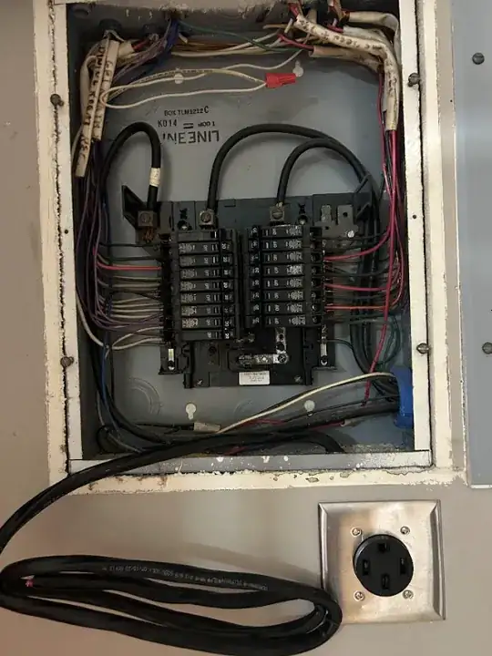

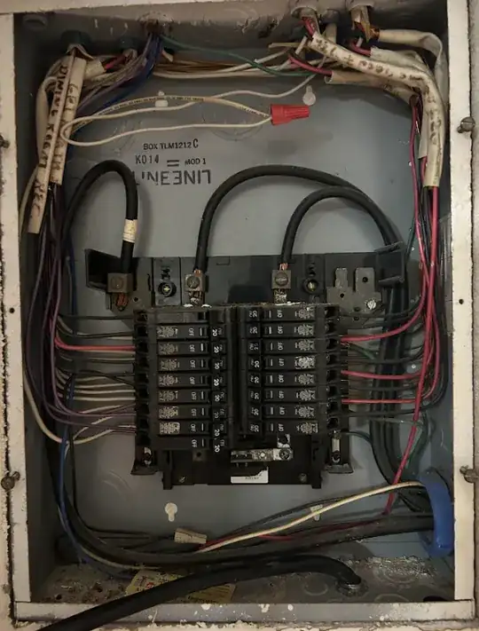

I have a sub panel mounted next to my main panel that is supplied with a 90amp breaker. I would like to add a 50 amp breaker to handle a 14-50 plug for an EV charger.
My question is can the sub panel handle the load without overloading? Other than the pool pump, the rest of the breakers handle outlets and switches.
There are four open slots on the right and three on the left.
I installed a 14-50 receptable using 8/3 Romex and fed it into the box. I paused when I thought I may not have enough amps in this panel.
