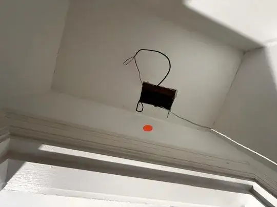

I have a normal, small closet (approximately 46”x24”).
I am doing electrical work and on that occasion I’d like to add some light to the closet.
I was thinking just adding a normal j-box (e.g. Carlon 18cu round ceiling light) above the closet door and running a simple #12-2 to it.
I could immediately put one of these ceramic fixtures with a light bulb on it.
But down the line I’d like to have something fancier … I thinking of a very flat LED light (similar to a recessed light but installed in said jbox), possibly with motion sensor.
Is this the best, future proof way or is there anything else I should consider?
Here is a picture taken upwards into the closet:
You can see the upper part of the door and on the ceiling the hole that I currently cut for other (unrelated) electrical work. It will be closed once the work is done. I marked with the red dot where I thought installing the round box for a closet light later on would be a good idea.
Note, all of this is lath and plaster, not drywall.

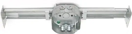

Metal Box
A metal box has a bunch of advantages over a plastic box and really no downsides that I know for this type of application.
Even though there are fixtures with integral boxes, so a separate junction box may not be required, I would still recommend putting in a box as it will keep your options open, including for any future replacements.
If you don't have any wood going across the ceiling in just the right place, one very common solution is an adjustable hanger/box like this example from Amazon:
adjustable hanger
These are the standard solution for fans, because an old work box won't hold up a fan safely even before it starts spinning. But there is nothing wrong with using them on "only" a light.

If you are thinking of a "pancake" thin LED light, they do not require a jbox. Just install it from the beginning.
A motion sensor can replace the switch for any light you install.
If there is some reason that you really want the ceiling box, you are good with your choice of the round. Most any fixture will be able to be attached to it. Just look for "surface mount" fixtures.
