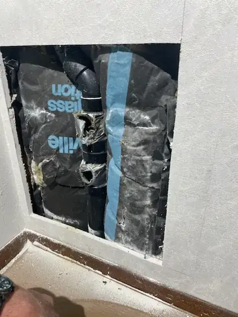

We had a plumber scope out our main sewer lines and vents. He found this bit of creative plumbing from an abandoned sink that is now in the wall of a room in the house where the smells were the worst. Carbon filters fixed the outside smells.enter image description here
