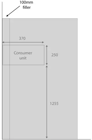

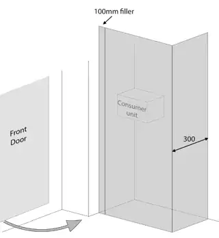

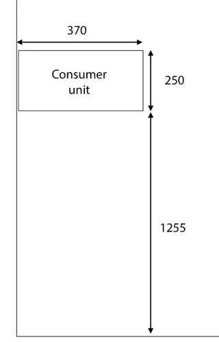

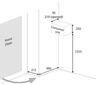

I have a consumer unit that is right in the corner next to my front door and I'm wanting to make the space a bit more useable for storage etc. The consumer unit is in its own metal enclosure so is fire safe and OK to put in a cupboard of some kind, I'm just wondering how I could go about doing this...
My initial thought would be to just cut out a piece in the cupboard on the side and back and slot it over, but the issue is that the CU flap will hit the wall as it's less than 18mm away from the wall so I would need quite a substantial cutout, possibly affecting the structural integrity...
The other issue I'm thinking about is that I'd like a filler piece to push the cupboard away from the wall such that the doors I put on it will be able to open more than 90 degrees. But if I do this, how would I be able to access the CU through the cutout etc as well?
Would it be worth just getting an electrician to move the CU 100-150mm away from the wall?
Is there a way of building this that I haven't thought about?
