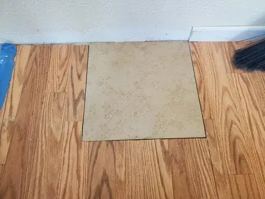

How do I install transition molding between my new hardwood and existing tile floors? has the floor and tile at different heights. What if they are the same level? Do I even need to do anything different on the vs between the titles?
I have a 5'x5' section of floor I'm changing from faux hardwood to tile.
This example picture is the 12"x12" test tile I set in place.
Test single square.

If you can get a nice straight, square cut of the wood at the edge of the tile, I'd just use some caulk that matches the grout color, between "wood" and tile.
