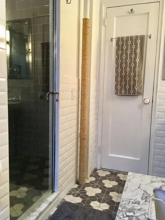

A fairly common way to deal with this is to wrap a fairly thick manila or sisal rope around the pipe. I've seen this in many apartments. It is cheap and easy, non-toxic, and works well unless you have a cat.
Here's what it looks like: Steam pipe with rope around it
Here's the blog describing it:
https://renov8or.blogspot.com/2019/10/rope-wrap-exposed-steam-pipe.html
