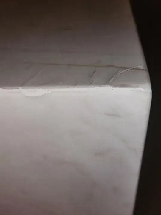

Install was today and it appears the slab was dropped as two corners on one end had their corners snap off. The stone guys clearly tried to repair it... and have more days of work to do. Can it be fixed?

Now in my opinion, I have seen a number of slab installs, and I have never seen one as sloppily done as this one. The joints at the corners are terrible. They need to blend in seamlessly. A pro installer should have no issue with doing so. With what you are left with as a so called finished product, tells me these guys either don't care about their work, or do not have enough experience to do it properly. That includes the handling of the stone to keep it from cracking to begin with.

One solution is to cut the island 1" shorter which could work depending on the cabinetry and allow the stone guy just to recut at least the top piece which would only cost them labor.
I'd get the stone replaced or cut an 1" shorter. That kind of defect is just too big.
The join isn't the best in the stone but not the worst I've seen either. Probably fairly average for a quartzite. You can certainly get better just depends on the price point of the job.
