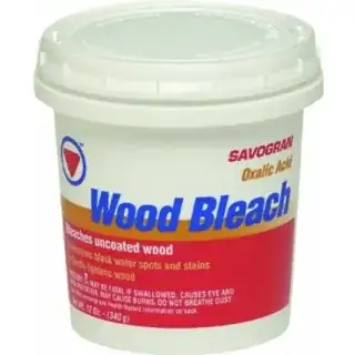

I would use Oxalic acid (in deck "brightners") before using bleach. Bleach not only breaks down color, but accelerates wood deterioration.
Be sure to neutralize as directed; with borax diluted in water or bicarbonate of soda in water.
