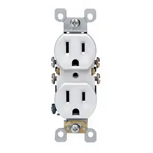

Its likely the box itself is recessed and the ears of the outlet is sitting on top of the tile, connected by longish screws.
The solution is to break off the ears and recess as needed. Spacers may be needed if the box is too deep. Similarly, a box extender should be used if there is a gap between the wall and the box.
Without plaster ears
With ears
