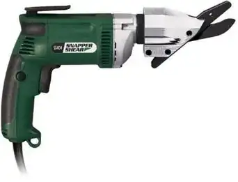

This is what a cement board cutting shear looks like (click through for amazon link):
