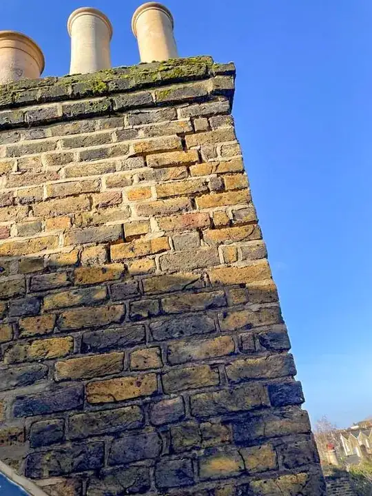

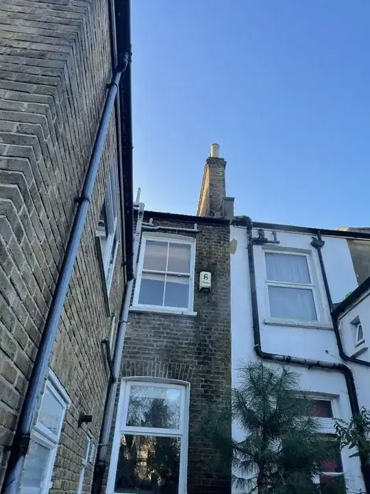

A builder has just scared the life out of me by saying that my chimney is about to fall down because it hasn't been pointed. How can he know just by a visual inspection?

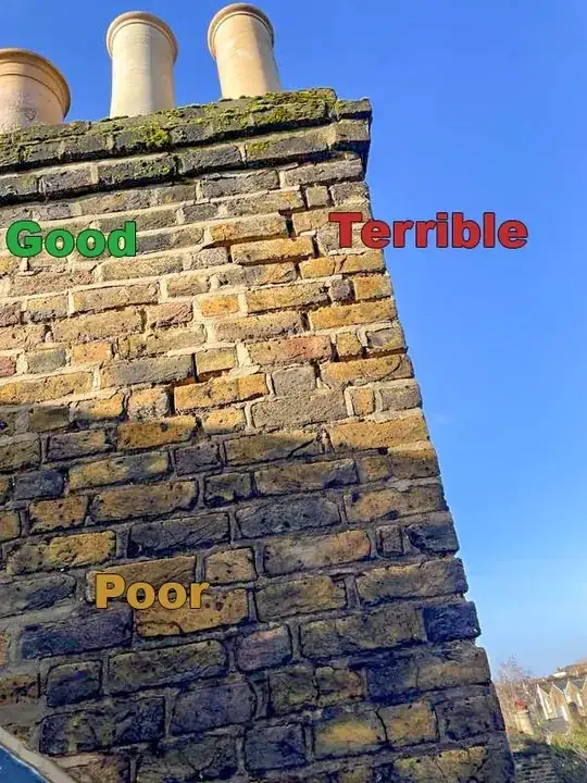

  1. Your second photo shows that the top left may have been pointed sometime in the past 20 years; the rest hasn't seen maintenance in considerably longer.

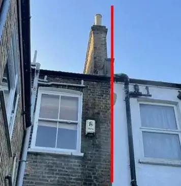

  2. Unless that's an optical illusion caused by the camera angle, your stack looks to be tilted over by a few degrees.
I'd book the guy in as soon as he can make it, or you might be raining bricks next time there's a storm.
If you really don't trust him - & frankly, I don't see why you shouldn't, that's some pretty obvious damage - get a second opinion.

If the tilt on the stack is as bad as it looks from that ground shot, it may need to be completely dismantled & rebuilt.
The way your question is worded makes me think you're not really sure what pointing is, or how someone can 'just see it'.
Pointing is the cement in-fill between the bricks. Your chimney doesn't really have much of that left. It disintegrates over time and needs replacing. 100 years is plenty of time.
This is what you can tell just from your photo about the state of the pointing…
