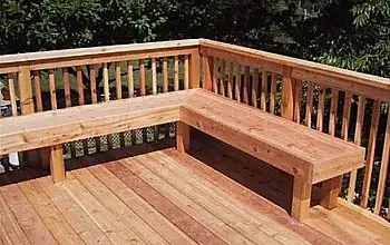

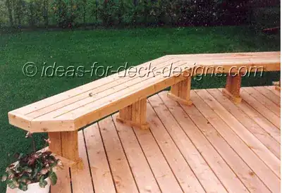

I have decking outside already, and want to use the same decking wood for my bench. Something similar to this
bench example 1
bench example 2

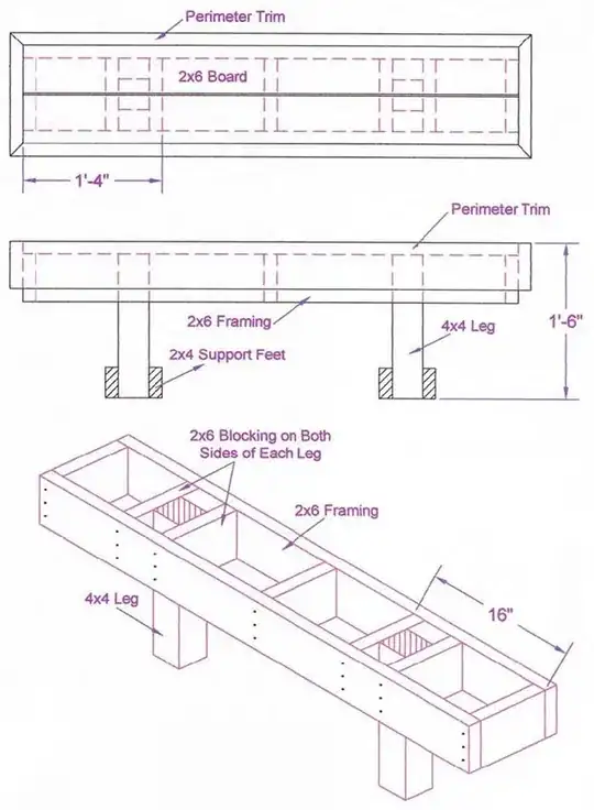

Simple really assuming you have the proper tools.
  • Cut your 4x4's to 18 inch length
  • Build a frame
  • Attach to the 4x4 posts
  • Cut wood to fit the surface of the frame
  • Add lateral support to the 4x4 posts
To join 2 benches at a corner, figure out your corner angle and modify the plans to match.
Wooden Bench Plans Website Wooden Bench Plans
