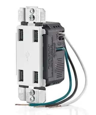

The problem is you're considering "receptacle + USB". But you only actually want to use the USB, and the problem is the receptacle part. Hopefully no space heaters, but who knows - maybe the next owner will use the receptacle to power a huge light display on the roof.
The solution is easy: USB only. For example, the Leviton USB4P-002-00W:
4 port USB
No general purpose 120V receptacle, so the only issue is how much possible power requirement this adds to the circuit. Not clear from the Leviton page. But 4.2A x 5V = 21W. It will be a little more due to conversion losses, but even if it is double, that's 42W, and at 120V that's ~ 1/3 A. If your existing hardwired loads leave at least 1A of headroom (also accounting for 80% continuous derates) then you should be fine.
You do need to check the requirements for your tablet or other device. USB current varies from the minimum 0.5A on up to 3A or possibly more. The 4.2A on a device such as this one includes all 4 ports - I am pretty sure you can't get that much current on an individual port. In particular, USB C can handle up to 3A at 5V, and even more with higher voltage. So check the specs to make sure that you get enough power. And also use a good quality cable - all cables are not created equal.
