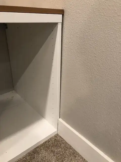

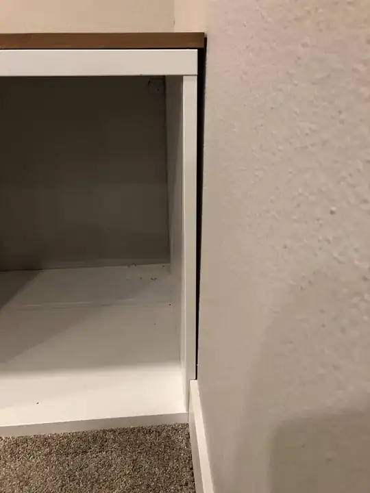

To fit some pre-built cabinets into a space I removed a portion of the baseboards so the cabinet is right to the wall not thinking about the doors. Is there a type of European hinge that as it opens will pull away from the wall leaving enough clearance for baseboards? I'm fine with cutting out the corner of the cabinet door to fit over the baseboard when the door is closed.
Edit: adding images enter image description here enter image description here

Remembering my job in a custom cabinet shop for 20 years, I do not remember a Euro hinge type that would throw the door further into the opening to clear something like a baseboard or wall panel. They have Euro hinges that will throw the door out from the face of the cabinet so it clears the next door over, but not toward the inside of the door opening.
However, if you are willing to shrink your door, you can mount an inset hinge, which holds the door further inside the opening from the pivot point. An inset hinge would clear the baseboard, assuming that the baseboard is not thicker than the side of the cabinet.

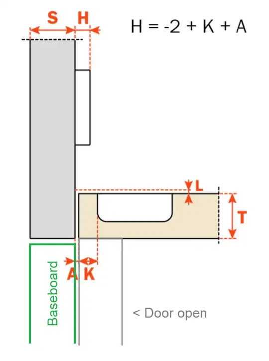

Here's what I anticipate you have now, where the door uses an Overlay Euro hinge and will easily hit the baseboard:
euro overlay hits baseboard

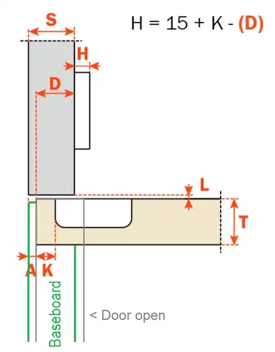

An Inset Euro hinge will clear the baseboard, if the baseboard is not thicker than the side of the cabinet:
euro inset clears baseboard

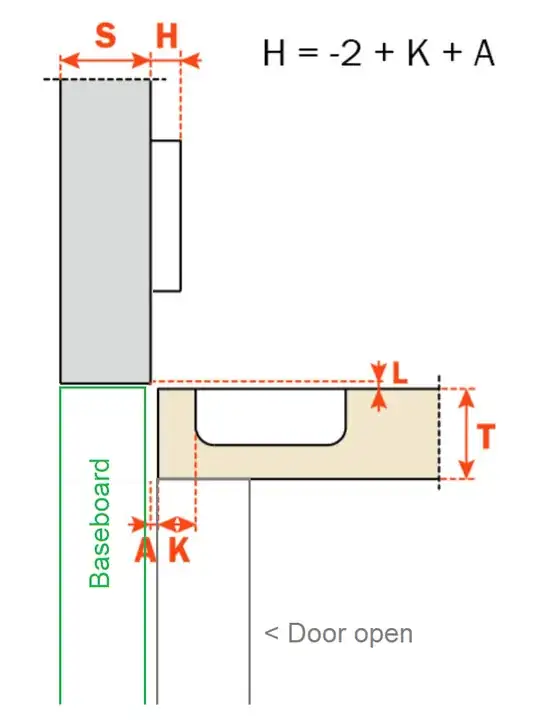

If you swap out your Overlay hinges for Inset hinges, using the same mounting holes you have now (you'll probably have to get the same manufacturer's hinges as you have now to maintain hole compatibility) then you'd get this:
euro inset yet overlay

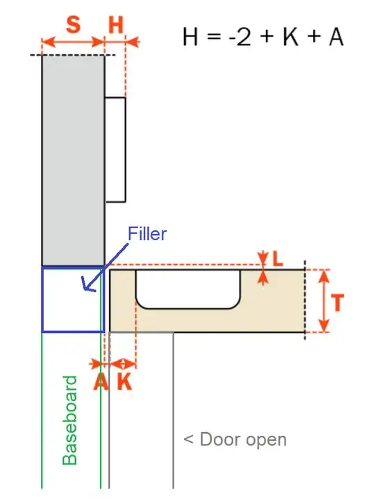

The door needs to be narrower, but it will still be the same height. You could also fill the gap at the side with a strip attached to the face of the cabinet:
euro inset overlay with filler
The baseboard-side door will have to be shrunk, and may appear smaller than the other door. Or you could shrink them both equally by half the required amount.

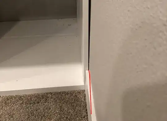

You could cut the baseboard at an angle: superimposed line to show how to cut the baseboard to allow for partial door opening
This won't allow you to open the door completely 90 degrees, but it does mean you can use the normal door and hinge. Note the slight change of cut angle near the hinge point to allow for the door when closed.
It will expose a bit more floor which might be fine if there's enough spare carpet tucked under the baseboard. Alternatively, you could leave a bit of baseboard in place at the bottom and paint it white.
Additionally, if there's a run of cupboards, there's often a 5mm or so gap between cupboard doors. If you can add shims and/or use the lateral adjustability of the hinges you may be able to accumulate enough gaps so that there's enough room for the door at this end to open, possibly in combination with the above.
