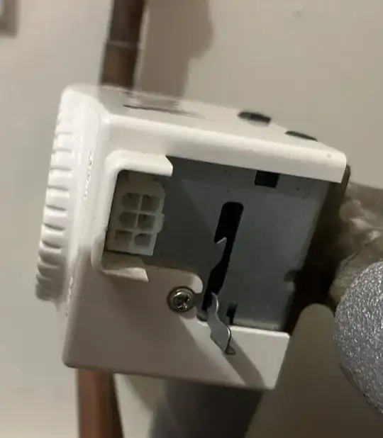

I have a ESI ZV-222/W valve I need to connect into my central heating system in order to replace a faulty valve. The ESI ZV-222/W is a spare I have, and I do not have a lead or connector for it.
What is the name of the connector or lead that I need to purchase in order to connect it to my system?

I would say it is a JST-VL male connector. Try JST.com to find, and then electronic supply stores for product.
