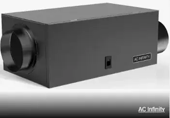

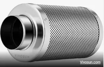

If your microwave has built-in ducting capability which could have been used to vent outside if your home had the facilities, you can add an inline duct filter (web-search) to the output of the ducting setup on the microwave:
Vivosun inline duct filter AC Infinity inline duct filter
(not affiliated or endorsing, only examples)
Attach such a setup to the output of the microwave duct, and vent it inside the cabinet above the microwave or an adjacent cabinet. A screen panel on the cabinet door may be required to let the filtered air out, and an inline booster fan to overcome the back pressure on the microwave fan may be required.

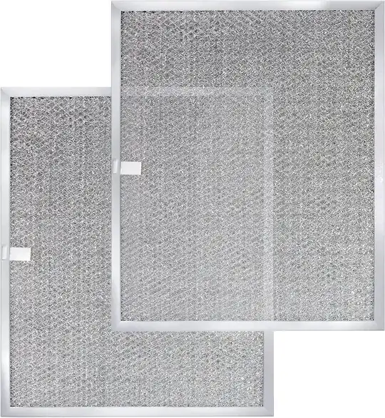

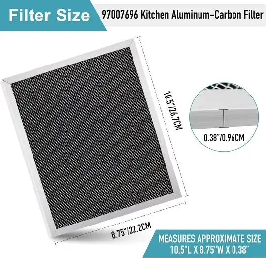

Unfortunately a range exhaust that vents internally is never going to work "great" however they make charcoal filters specifically for internally vented range exhausts. Typically the filter would just be a steel mesh that catches some oil but not very much smoke. The charcoal filters do make a noticeable improvement in performance but need to be replaced more often as they are not washable.
An example of a charcoal filter: enter image description here
Versus what you normally find in a range hood: enter image description here
