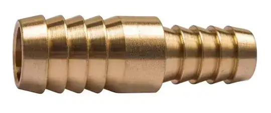

I am just trying to connect an 1/2” vinyl tubing (this one) to a smaller 3/8” version.
I got this 1/2” to 3/8” barb reducer but it’s way too small and doesn’t fit.
Why?
Which part do I need instead?
divB
  • 1,780
The device you have linked to is for PEX pipe, which needs special crimpers. It is not deigned for vinyl tubing.
You need one of these: barb hose reducer barb hose reducer
(Admittedly, the link is for a set of 25, but a single wuold surely be obtainable.)
You will also need hose clamps.
