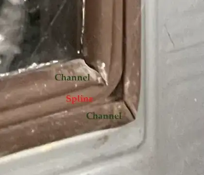

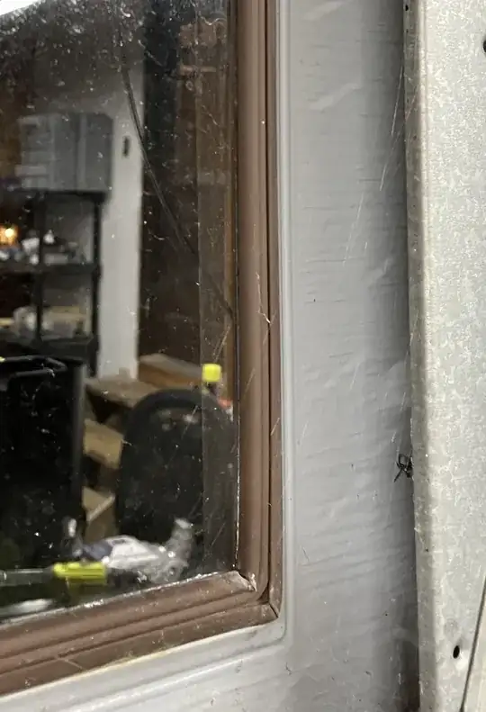

Picture below is a close up of one of the corners of the window pane from the interior. (Spiders will be removed before painting)

That appears to be a "spline-channel" type of window fitment, where the room to insert the window-pane is created by having no spline in the channel, and then the window is held in place by inserting the spline into the channel.
Laeled detail of picture of window corner
So, to remove, you would pull the spline out of the channel (look for a cut end as the easy place to start pulling.) Might want to get a suction-cup on the glass first to reduce the odds of breakage.
I'm not finding that exact window trim type on a quick search, but it's probably out there somewhere from a specialist garage door parts supplier.
My thoughts are that attempting to remove the glass may damage the glass and/or rubber molding. Why risk it?
It is not a big deal to mask the window with masking tape and then paint the molding. There are paints that will stick to rubber.
