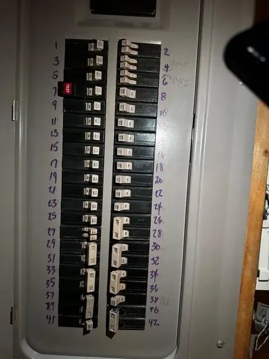

I just purchased an EV and I'm looking to add a 50A circuit but my panel is full. I have 200A service and the panel (and service entry) is all the way on the opposite side of the house from the garage. There is no chance we are even close to 200A peak in this house. The main breaker is a CSR 25K, 200A.
  1. So first problem is my panel has no empty spaces. There are a bunch of circuits labeled lighting, so I think I can either
  • combine those into double breakers or
  • put a junction box above the panel and combine the lighting circuits into one or two circuit breakers.
I did purchase a current clamp so I can verify if this makes sense. What is the recommended course of action here?

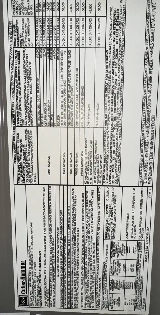

  3. Also, on the label, I noticed a limitation of a max of 140A per stab. Looking at the panel, isn't position 39 (50A) and 40 (100A) violating that limitation? How is that limitation applied with double breakers?

I would recommend a Load Calculation for peace of mind. But assuming that works out OK, the easy solution is to replace a bunch of 15A breakers with half-size breakers:
Eaton 2x15A
just like you already have in space 27 (and similar to the 20A in 2, 4, 6).
The one thing you must watch out for is Multi-Wire Branch Circuits. You shouldn't find any because those breakers should be handle-tied. But if you start to replace breakers and find two (hopefully next to each other) that have black and red going into one cable then that's an MWBC and special rules apply.

As far as bus stab limits, each pole of a breaker counts. So a 100A double-pole is 100A on one pole and 100A on the other pole, and yes it sounds like you already exceed (technically, fortunately your loads are low so it hasn't caused a real problem) some of those, which can be resolved by putting big breakers across from small breakers. One way to maintain a clean look (not that it matters) is instead of "all doubles at the bottom" make it "all doubles on one side".
But one thing to watch out for: 2 half-size 15A breakers is a 30A bus stab instead of a 15A bus stab. 2 half-size 20A breakers (like 2, 4, 6) is a 40A bus stab instead of a 20A bus stab. But since Eaton only offers half-size breakers in 15A and 20A sizes, with a 140A maximum stab you are OK with 100A across from 2x15A, 2x20A or any full-size breaker up to 40A. Just not 50A or above.

Really? I see a panel with seven 240V loads - 30A, 20A, 50A, 30A, 40A, 50A, and - concerningly - 100 amps! That 100A is a wildcard, and it can't just be ignored.
Trivial. I see tandems all over your panel, so clearly your panel is new enough to be post-CTL or is subject to the post-CTL waiver Eaton obtained from UL. So this is a 42/84 space panel and you can tandem to your heart's content.
Absolutely, that is busting stab limits, and stab limits are serious business and should be optimized to minimize. So yes, move breakers so two 15s or 20s are across from the 100.

Responding only to Question 1, creating space:
If you want to put a junction box above the panel to combine circuits rather than just do it in the breaker panel I recommend you buy a large metal enclosure for this, with lots of prepunched knockouts, run couple of 3/4" conduits between the enclosure and the breaker panel, and use loose wires through the conduits to run the combined circuits. It's easy and cheap to maintain. For example I recently bought an 8x6x4 box with 14 knockouts for $20 for a similar project. I have two main panels so it was better for me to use a box like this with conduits to both. For you, there is some sense to the other answer that says you don't need this, you should do the patching inside the breaker panel.
How to identify circuits for combining:
  • Look for circuits that were added just for one outlet or one light because that was the easiest way for the electrician installing that outlet or light to get the job done.
  • Look for circuits that fed window A/Cs before central A/C was installed, or that were installed for similar now-defunct purposes.
  • Look for circuits that do nothing at all. You know they are there, you always wanted to disconnect the cable and gain back the space. Well, disconnect the cable, cap it and move it out of the way, and go for it. You can always put it back.
  • Look for general lighting circuits (including outlets) that just don't have much demand any more. You used to have a bunch of 500W halogen lamps, and a couple of 36-inch CRT TVs and a few 300W desktop computers. Those are all gone, and you can combine almost anything you want.
