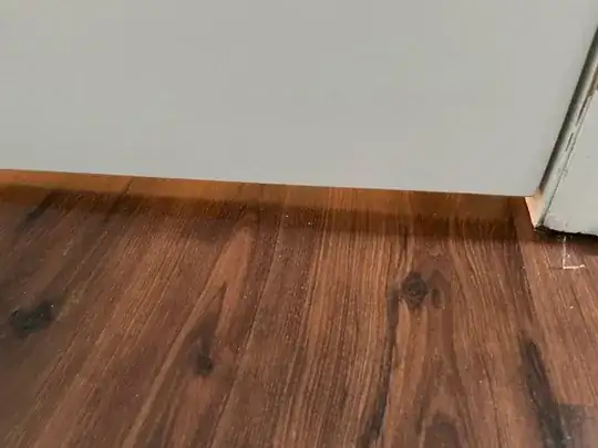

I have an interior door over a hardwood floor. The door lets in a lot of sound through the gap between the door and the floor. How do I soundproof the gap between the door and the floor?
a door with a gap under it
I tried adding a "draft stopper" strip like this last year. It helps significantly with the sound, but degrades a little over time, so I'm looking for a more robust solution. Is there some better version of "weatherstripping" I can use?
Adding to the complication, the door isn't hung at exactly 90 degrees, so the gap is slightly larger when the door is shut than when it's open. (Anything used to cover the gap needs to be flexible.) In my case, the gap is rather large - 1.5 in.
