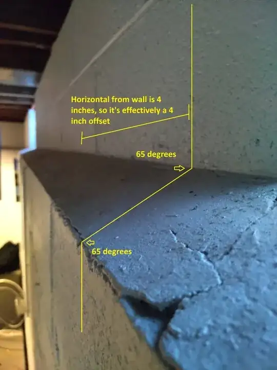

I'm using 1/2 inch conduit to protect 14/2 romex as it goes up my basement wall (before I run it unprotected along the basement ceiling to the panel).
My basement wall runs vertical for a ways, bends away from me/center of room at 65 degrees, goes 4 horizontal inches, reverts 65 degrees back to vertical, and then finishes with more vertical to the ceiling. Hence, when bending the offset, that first "wall" corner is going to be on the inner side of the first bend.
The way i see it, running conduit up the wall would be, effectively, the same as a 4 inch offset (the horizontal depth of the "inner wall" of the basement).
Here's a picture.
So far as i can tell from reading and YouTube explanations/demonstrations it is the case that bending a 65 degree offset isn't difficult. 65 degrees isn't a standard angle, but the trig calculations are pretty straightforward.
What I'm worried about is adhering to the corner as much as possible. Based on what I've seen of conduit bending, it is the case that the bend doesn't actually start at my mark. The conduit actually starts moving away from straight before the mark.
So if the 65 degree bend in the concrete wall is sharp and i want my conduit to have a 4 inch offset and stick as close to the wall as possible then where should i actually mark my bend in comparison to the corner?
