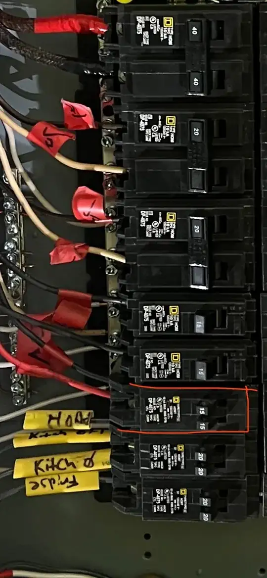

enter image description hereI have a 12/3 MWBC feeding one single bedroom that is about 8x14 in size. It feeds two lights and approximately 5 outlets. In the panel, each leg was on a 20 amp single pole breaker, one on top of the other. Needing to make some space in the panel (allows 48 circuits), I added some tandem breakers and placed this MWBC on a 15 amp tandem.
Are MWBC permitted on a tandem breaker? If so, does it need a breaker tie? Should I just replace it with two separate single poles breakers (the way it was) and add a breaker tie? Thank you in advance!
