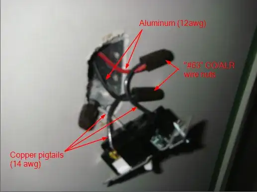

  • Use a pigtail connection: Sometimes it is not possible to find CO/ALR switches with the function or style you need. You can use a copper wire to connect to the switch itself as usual, and then a #63 wire connector to connect the copper wire to the aluminum one. Here is a picture of a 3-way dimmer switch I installed using this method:
    alt text (apologies for fuzzy picture)

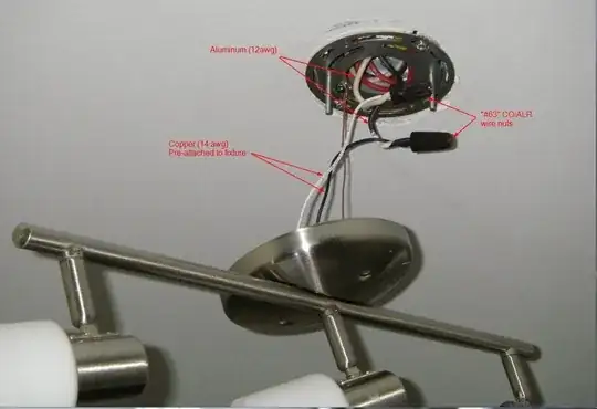

    Note that you do the same thing with switches that have wires coming out of them already (like most dimmer switches do) or any other fixtures.
