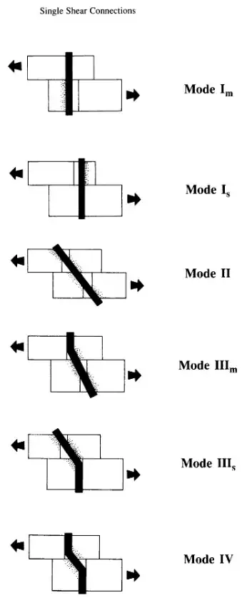

For your single shear connection, there are 7 failure modes visualized below from the Appendix chapter of the NDS (page 184). Standard practice is to compute all 7 and take the smallest as the strength. If you're anchoring through a piece of wood trim and want to use the NDS instead of that technical report, then you would need to attach the trim sufficiently so it acts as a structural member. It can't shift before the ladder's fasteners reach the smallest failure load among the 7 modes. Given such structural trim, you can pretend that the framing thickness is the actual framing thickness plus the trim thickness. I really don't like this strategy, because for all I know your trim is some engineered wood product without even the strength of SPFs. And I've seen trim weathered into dirt, although maybe that's an unreasonable expectation for a structure with 4+ levels.
7 failure modes
Assuming that the trim is at least as strong as SPFs and attached sufficiently, you can use the NDS to compute your fastener design strength. Section 12.3 of the NDS is where to find the lateral strength prescription (starting on page 83). The 7 failure mode computations are nasty, but don't worry about that. The American Wood Council maintains a connection calculator that will compute them. Take note of Fem and Fes in the expressions, though, and observe Table 12.3.3 on page 86 to see how the specific gravity plays a role in the failure mode values. For the connection calculator, my instinct is that your ladder has thin brackets. I would use steel for the calculator's side member, choosing its thickness based on the bracket's thickness. Use load duration factor CD = 1.25. Depending on your climate and rain exposure, you might use wet service factor CM = 0.7 to account for high moisture. The other 2 factors in the connection calculator should be 1.0. When in doubt, use Spruce-Pine-Fir (South) as your lumber species.
