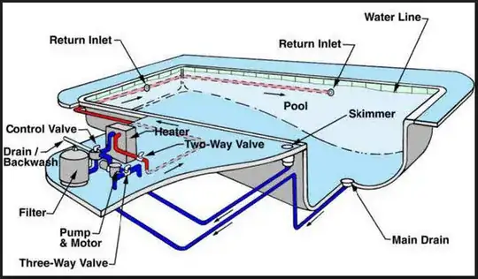

Let us start with some basics of how the pool plumbing works. This picture helps to show the basic connectivity of a typical swimming pool system.
(Picture borrowed from website)

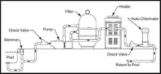

Note that not all pool setups have two separate pipes to draw water from the skimmer or main drain and bring it up to the to the pump station as shown above. On some the main drain T's into the bottom of the skimmer and then a single line goes to the pump. The following picture shows this alternate type connection and when one wants to drain the pool the skimmer intake is blocked via a diverter in the bottom of the skimmer.
(Picture borrowed from here)

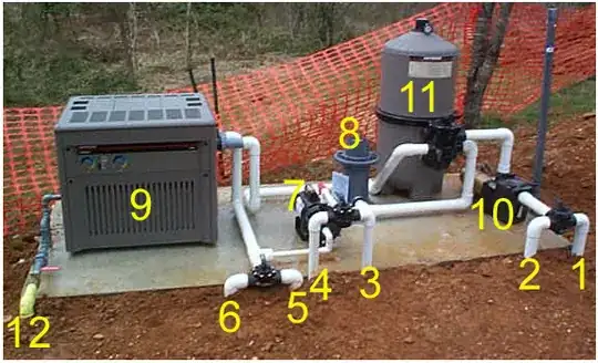

The above picture shows the basic plumbing circuit for water flow when the pool is operating in the normal filtration mode. Not shown are the various valves that are used to re-direct the pump water flow backward through the pool filter to suppport the back flush operation. Here is yet another picture showing a setup with all the valves.
(Picture from here)
In the above the numbered elements are as follows:
  1. Swimming Pool Skimmer Line
  2. Swimming Pool Main Drain Line
  3. Swimming Pool Slide Line
  4. Automatic Pool Cleaner Line
  5. Swimming Pool Return Line
  6. Swimming Pool Return Line
  7. Automatic Pool Cleaner Motor
  8. Auto Sanitizer
  9. Swimming Pool Heater
  10. Swimming Pool Pump
  11. D.E. Pool Filter
  12. Pool Heater Gas Supply Line
