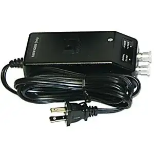

Yes, satellite dishes are frequently powered by DC current over the coax connection. The DC power comes from a "line power inserter" which will attach somewhere to the coax before it reaches the TV's. It may be a single connection or a splitter as well, but either design will connect to an outlet.
Edit: As others have mentioned in the comments below, the injector may also be built into your set top box.

It's unclear why you're getting a shock off the dish itself, you shouldn't. It sounds like there is another power injector as indicated in BMitche's answer. Hunt it down and remove it if needed.
