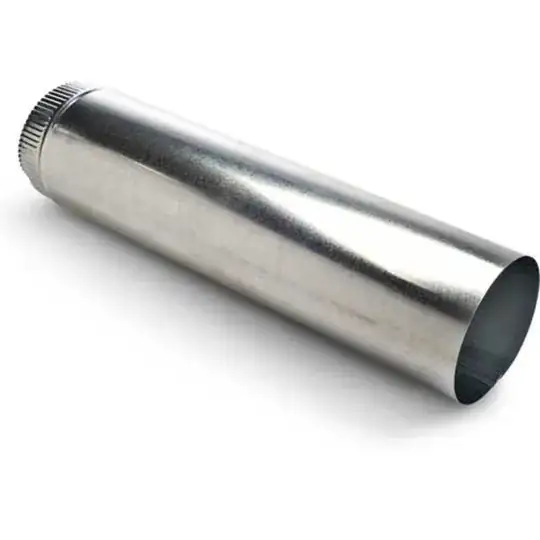

What I did that worked really well for both squirrels and raccoons climbing a 4x4 post I had bird feeders on was to get a piece of round snap-together HVAC duct around the post up as high as I needed. Since it's round and metal, they can't get their claws into it for any grip, and it's big enough around that they can't wrap around. For extra measure I did spray it with silicone spray after I put it up, but I don't know if that was really necessary. enter image description here

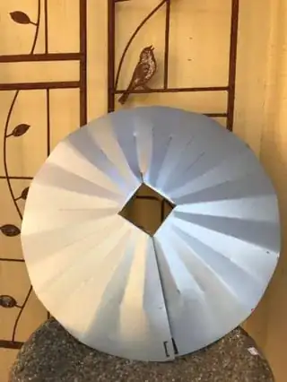

B: For an existing post of a non-standard size, attempt to build an exclusion cone from metal flashing. Mock up the shape with cardboard or paper to get a pattern and cut from metal flashing so you have a cone or pyramid flaring away from the pole downwards, and screw or nail it onto the pole.
Given the post is not really a non-standard size, (might be for your local bird feeder supply place, but not for web ordering) looking for a 4x4 squirrel guard and selecting one with a "wrap-round" installation method (a joint or seam) would (attempt to, see A:) solve your problem most easily, evidently. They are available. A roll of flashing and a pair of aviation snips might cost less and give you some tooling and material for other jobs, though.
Wrap around 4x4 baffle
Image Source example, not endorsement
When positioning either the HVAC pipe or the flared cone fashioned from flashing, or both if you use the combination, a bonus discouragement is to hang them loosely around the 4x4 as the movement this allows will lessen the critters ability to grip. Easy to do, just drill a hole on one side near the top and hang the device of choice from a nail above.
Also, if you use the HVAC pipe, snipping half inch triangles at the bottom edge and pressing every other one inward a little bit will discourage them from trying to go inside the pipe between the wood and metal, as this creates very sharp points.
