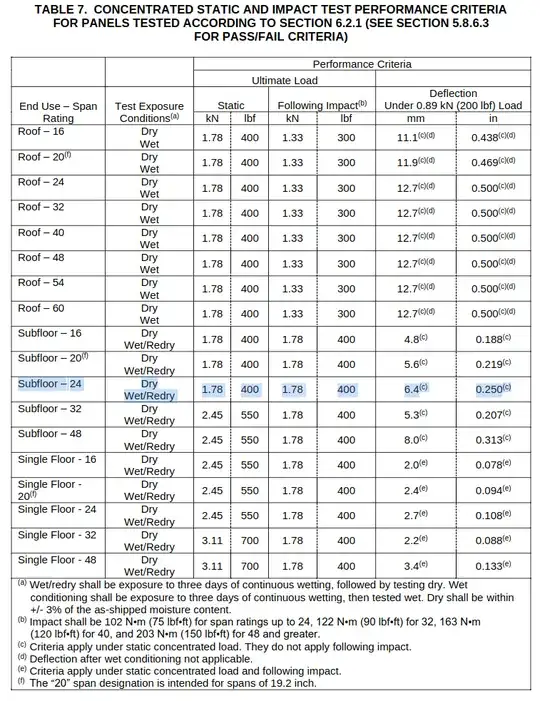

Your 23/32" plywood should have a span rating of 24" for subfloor applications. I've highlighted the testing standard information for your plywood:
plywood specs
Since your 24" rated plywood has been installed to joists on 12" centers, your worst case deflection under the 200# test load should be about (12"/24")3 = 1/8 times the tabulated maximum deflection of 0.25", i.e. (1/8)(1/4") = 1/32". For your 50# concentrated loads, the anticipated deflection is (50#/200#)(1/32") = 1/128". No worries there, then, with an span length over 360 of (12")/360 = 0.033" ≈ 1/32". I might start worrying for a steady 200# concentrated load with its 1/32" deflection matching L/360.
The tabulated 400# minimum static load should double to an 800# minimum capacity for your installation.
The pressure number you generated was a little misguided. Assuming that the desk is rocking across two legs, I get a maximum bearing pressure of (219#/2)/[(2")(1.25")] = 44 psi. The bearing strength of plywood is about 360 psi, where that corresponds to about 0.04" of crushing. Obviously the plywood has no problem, but your laminate's spongy layer might not like the pressure.
Another check for concentrated loading would be punching shear. For your plywood, the 2018 Manual for Engineered Wood Construction provides a through-the-thickness shear strength of 115#/in (Table M9.2-4). For your 2"x1-1/4" leg the punching shear strength is (2"+1.25"+2"+1.25")(115#/in) = 750#, so no problem there.
