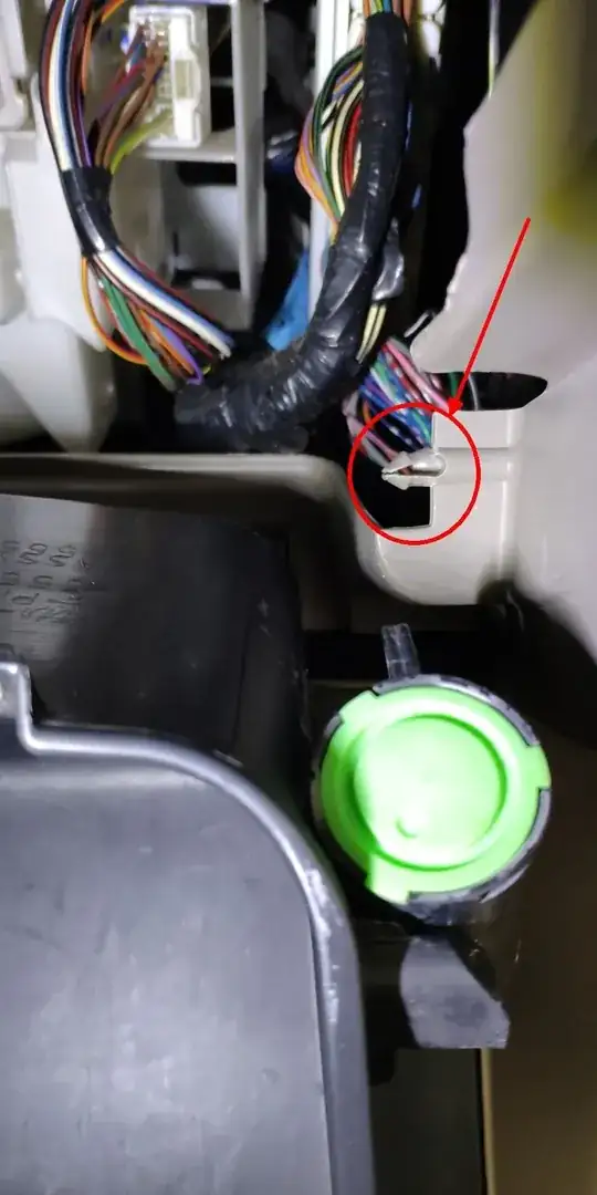

But the "mechanic" that did this 1st time a while back didn't understand and just pushed the box down until the soft plastic retaining clip that holds the piston/strut thingy at top gave way and seems to have permanently deformed. (see pic attached.) It has never really worked to retain that thingy since I've owned the vehicle (purchased used) such that the glove box occasionally falls out farther than it should when the piston thingy drops off the retaining clip. And since that retaining clip is an integrated part of the plastic housing around the compartment, it can't be individually replaced.
So my question is: are there any approaches or suggestions as to how I can get this thing to work as originally intended? Note that space/thing are really hard to get at even with a couple of fingers...it's like playing Operation (tm). For instance, I've tried to place a small folded wad of paper in between the clip prongs to hold the clip more open...I found it pretty much intractable to get at it with enough precision such that it would stay, especially when trying to get the piston thingy to hang back on it.

Very, very, carefully apply heat. Enough heat will allow the thing to bend and stay put when cooled. Too much heat will melt things too much and cause further damage to the impractical to replace plastic dash.
