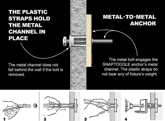

Snap toggles.
A snap toggle would be perfect in this situation, most are rated for much higher weights than typical drywall anchors.
These anchors specifically say they are rated for much higher than your expected load and I can say from personal experience they are more than equipped to handle an 8kg speaker.
I have mounted all kinds of stuff with these anchors and none have failed as of yet.
Image Source: Amazon Snap toggle anchor

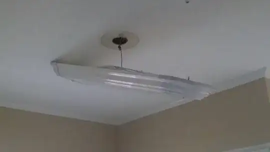

It's not often I have a visual representation, but here it is
Ceiling anchor fail
This was our repo house that had a bargain basement contractor brought in to slap some lipstick on and keep moving. So you replace the light fixtures for an "updated" look. There were many corners cut for the sake of money, and this was one.
This fixture wasn't that heavy, all things considered. Maybe 8-10lbs (about 3-5kg) with 4 fluorescent bulbs in it. There was barely anything to it beyond the plastic housing. At least they cranked all those wire nuts on well...
This should have been done with flip toggle bolts. The problem with the screw-in types is they are just a giant inclined plane with gravity working directly on it. For any application, this is almost always a matter of time.
I put flip toggles in and the fixture never came down by itself again. Yes, you can buy pricier things, but for light duty you just can't beat the toggle bolt. And, in my case, the old anchors had already made convenient holes for me to put the toggles in...
