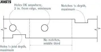

Notch depth is 1/6 of joist depth, maximum. No notches at all in the center 1/3 of the joist.
notches and holes in joists
Image source, no endorsement implied.
Holes, of 1/3 joist depth or less in diameter may be placed at least 2" from the edges. The center of the joist is the least impact, structurally.
