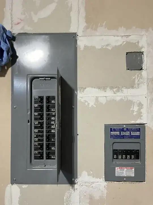

We purchased this home a few months ago. Over the last six decades it’s had a lot of work done, and quite a bit of electrical work in the two years prior to our purchase. A tree took out the main electrical service in 2021 and the then-owners that the incoming service routed to the other side of the house and I believe at that time the circuit breaker panel was replaced. There is a 100A sub panel as well, that I believe is older than 2021 because it refers to an irrigation well that was removed before 2021.

We are dealing with a home warranty (provided by the seller). An electrician came out (the manufacturer suggested I start with the electrical side). He was very pleasant and seemed earnest enough, but not terribly knowledgeable and didn’t seem to know where to start. I suggested he start by checking for voltage drop at the equipment. He tested voltage here:

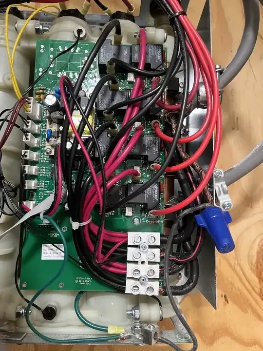

view of tankless with cover removed
I believe what he tested was black to red. He found a little over 240V for each pair whether all the equipment was off or running (malfunctioning). I believe he tested on the input side of those connectors if that matters.
He also tested at the indoor air handler and outdoor heat pump and found slightly over 240V at each. I don’t remember if we checked the voltage at the HVAC components while the water heater was running.

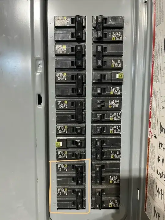

He tightened all the terminal at each breaker. He did not do anything with the main service lugs or anything “upstream” of that. He stated the panel was suitable and the previous electrical work all looked fine from what he could see.

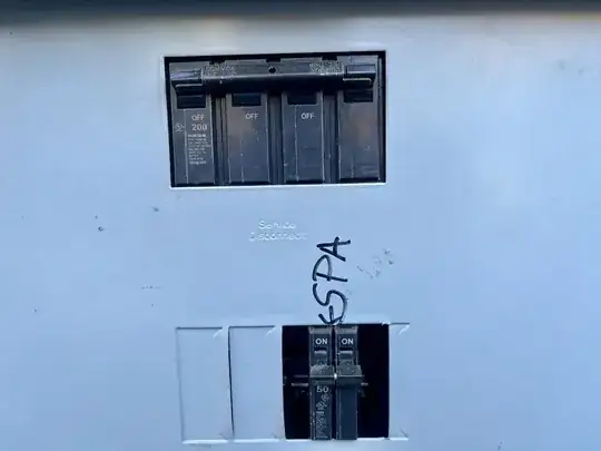

Meter Main:
Meter main panel

**IMPORTANT UPDATE**
Thank you to Ben Voigt and Jim Stewart for noticing that OP's highlighted breakers for the water heater are 2 60A double-breakers rather than 4 30A double-breakers. That is a major code violation and a huge safety issue. We need to see what wires are actually connected, but this (a) must be fixed and (b) may be the source of the problems.
There are 3 likely configurations:
  • 8 30A (e.g., 10 AWG) wires in 4 cables
In this case, there are 2 hot wires on each breaker connection. In certain fault situations, up to 60A could flow on a 30A-rated wire without causing a breaker trip.
  • 4 60A (e.g., 6 AWG) wires in 2 cables
In this case, there is only 1 hot wire on each breaker connection. The wires are protected properly by the breakers, but then joined up to each feed two heater circuits instead of one, allowing for a heater circuit fault to overload up to 60A without tripping a breaker, damaging the heater more.
  • 4 30A (e.g., 10 AWG) wires in 2 cables
This is the worst of all. The wires would not be properly protected and would routinely be overloaded at 60A on 30A-rated wires.
All of these are code violations (though some worse than others). Need to carefully remove the front of the breaker panel and get a picture of the wires going into the water heater breakers.
The good news is that there is a Square D HOM 30A quad breaker so if the only issue is the breaker and there are sufficient wires (8 individual 10 AWG or larger wires, or 4 10/2 cables) then this can be fixed by replacing the 2 60A doubles with 2 30A quads.

Confirmed based on meter (CL200) and meter main (200A service disconnect) that this is 200A service. 200A is more than enough for a typical all-electric house as long as it does not include tankless water heating. But with tankless water heating @ 120A that leaves only 80A for everything else. It is plausible (but we still don't know actual current draw/rating of the heating system) that the heating system plus ordinary loads (lighting, computers, etc.) raises the entire to load to 200A or beyond. Main breaker is not likely to trip quickly unless current draw is substantially (20% or more) greater than 200A, but voltage drop can be a real issue at 200A if the entire electrical is marginal in any way.

I don't know if this is the cause of your problems... But I wonder if a screw driver, some ox guard and 10 minutes to plug in a cable would help.
Bottom wire circled
One thing that has bothered me about this picture from the very start is the bottom right input wire..
Yes I know the electrician claimed that it is all good and well connected... But to me it looks like the bottom wire is not properly screwed in... I can see 1/4 of an inch of copper, and the strands are in a perfect circle.. I have put a lot of stranded wires in terminals... and they always flatten out a little bit when I tighten the terminal wire..
Additionally there is one red-striped wire connected to red... and one connected to black. While it shouldn't matter as this is 240V. I think it would look better if they were connected the same way. red-strip to red wires... black to black, etc..
