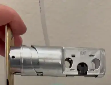

I have a Schlage Encode and unlocking and turning the thumb turn. I was able to take it apart but doesn’t seem like it’s catching when I turn it manually. Also a piece fell out that I’m assuming may be important. Any ideas on how to fix?
Deadbolt picture
This video is of my freely turning the part to move the tongue

That is a broken deadbolt. As you say, it appears to be missing an important component. The Encode uses a tapered deadbolt so that it can more easily be operated by the small motor inside the lock, so I wouldn't expect it to be reliable with a standard deadbolt. You will likely need to go directly to Schlage for the part.
