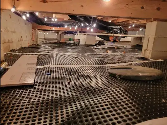

I have found that old Christmas lights work great. A few light bulbs burned out on our Christmas lights. My wife wanted to get rid of them. I hung them up in our crawlspace and it makes a huge difference. Of course, LED lights would be even better. Good luck with your project. crawl space lit with old Christmas lights.
