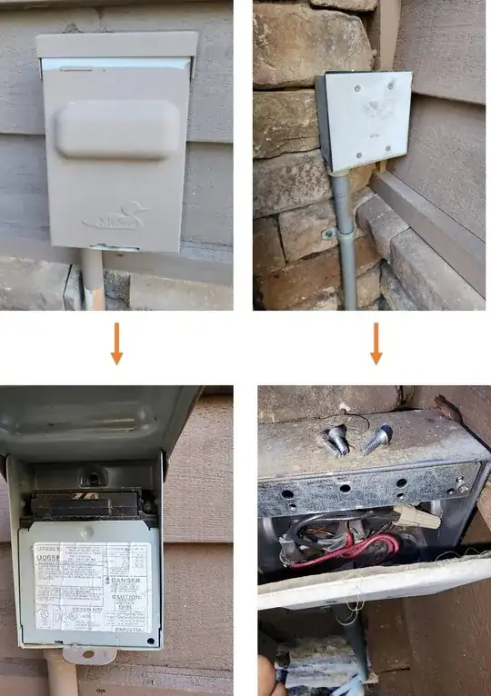

Lo and behold, on the outer wall of my garage I found these two boxes a foot from each other. One looks to be a hot tub disconnect and the other has some power wires with wire nuts. Pictures below.
Assuming these wires are the 50amp power for the hot tub, can I just instead have it routed through the wall to the garage and have the outlet installed there?enter image description here

Yes, you can reuse the 50A feed for EV charging. You need to make sure the wires are appropriate size (6 AWG or larger if NM cable (a.k.a., Romex), 8 AWG or larger if individual wires), though if it turns out they were undersized you can use them (with a breaker change) for whatever ampacity they can handle. See an ampacity chart for details.
But don't install a 14-50. That is the wrong way to do things. Now that Stellantis is on board, all the major car manufacturers in the US are moving to NACS over the next 2 years, and providing adapters until then. So get an NACS charger (the Tesla charger is great, but others are perfectly fine as well) and hardwire it. That gives you a few advantages:
