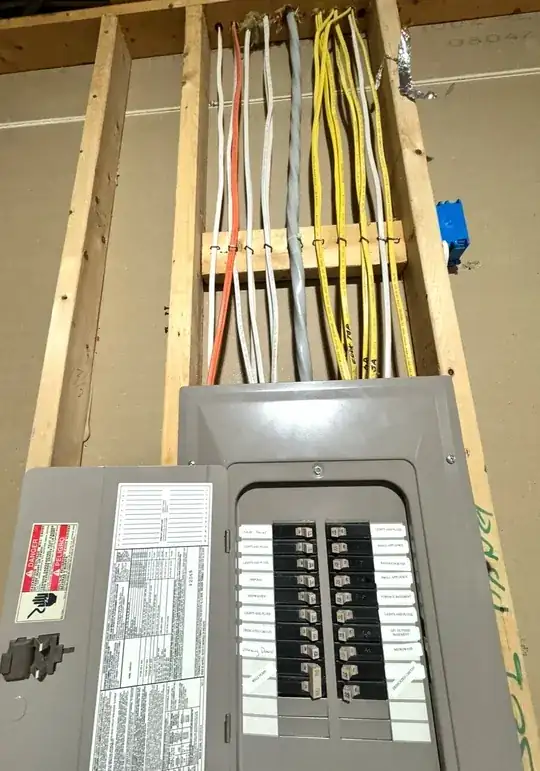

There’s a sub-panel directly below the cook top and the main panel is prohibitively far away to run power from.

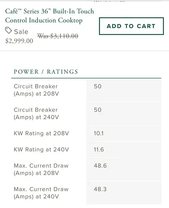

Here’s what the cook top calls for enter image description here

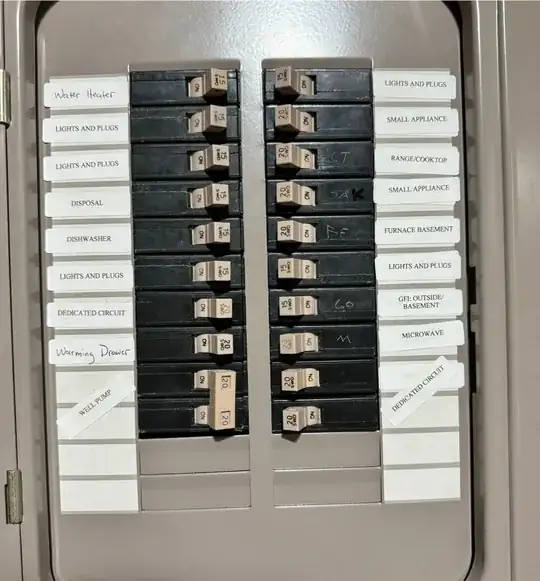

And here’s the panel. The biggest draw would be my well water pump rated at 240/30.

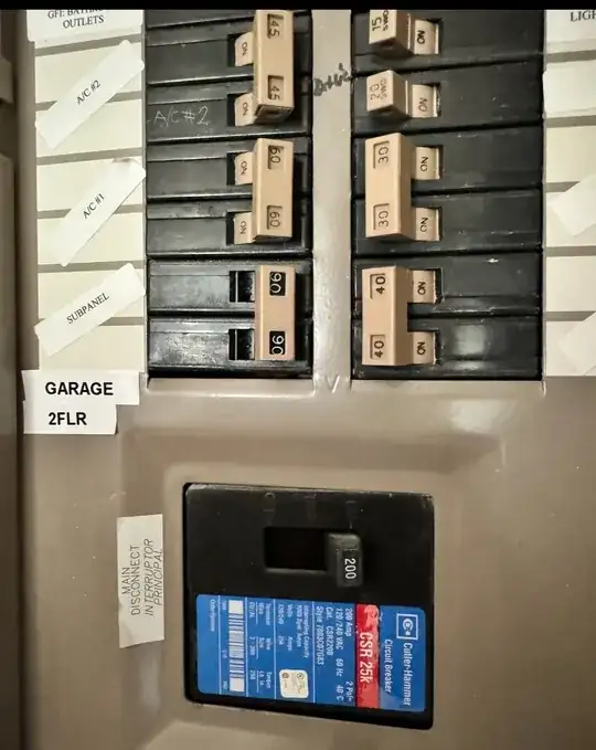

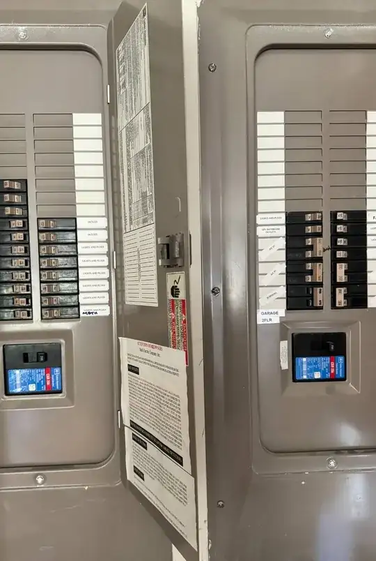

Excellent info on the load calculation, I will have that done. My main panel(s) show a 200a breaker on each and the Sub panel is fed off the right panel and shows two 90a (edited my mistake) I also attached a better picture of the sub panel cover

You need to do a Load Calculation. Actually, two of them - one for the utility service/main panel and another for the subpanel. You are adding 50A to your load. That's 1/4 of a typical 200A service, so it is significant. It is even possible to have smaller service if your cooktop, water heater and heating are all gas.
Update: OP uploaded pictures of two 200A main panels, and both have plenty of space in them. That hints at a possible 400A/Class 320 service. If that's the case then total load will almost certainly be fine for the new cooktop and at first glance the subpanel feed of 90A is likely to be fine as well. But actual load calculations are needed. Except technically three load calculations:

Your gas cooktop may had a dedicated 20A 120V circuit, but the actual usage would have been < 1A and only for a few seconds at a time, as opposed to 40A 240V for a long time and peaking at 48A 240V.

If your subpanel has room then it is just a question of breaker spaces (which you have), the right size of wires, etc. So do the Load Calculations - to make sure you have enough capacity in your service and enough capacity in your subpanel (subpanel total capacity is determined by the breaker feeding it in the main panel) and if there is enough to add 50A, great. If there is not enough then we can discuss possible solutions.
