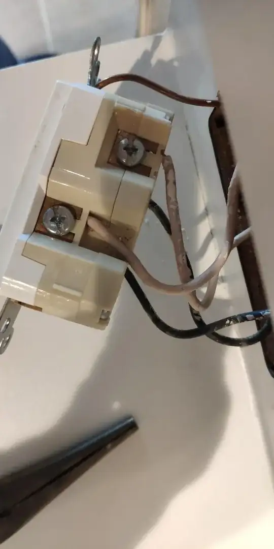

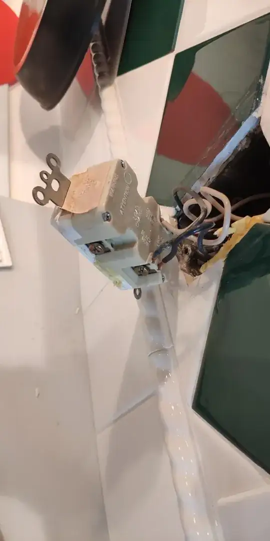

I am replacing two 25-year-old (original) GFCI outlets in my kitchen with these:
I am confused as to why they are wired differently (one has both sets of leads in to/out of same contact screws, the other has leads in at one contact screw and out at the other end)? Why? Should I change anything or wire new ones exactly the same?

In general, cables run from one outlet to the next to provide power to several outlets.
If a GFCI outlet is in the chain, it can provide GFCI protection to the next (and all subsequent) outlets by attaching to the "Load" terminals (the ones not providing power, in your case the ones covered by yellow tape). The downstream outlets would all be ordinary ones,but would be GFCI-protected. They require special stickers if so.
Or, the chain can continue from the other, "Live" terminals, the same ones feeding the GFCI outlet. Then the downstream outlets are not GFCI protected.
You have one example of each.
It saves money to use the "Load" terminals if you want to provide a lot of outlets for convenience in a room that requires GFCI outlets everywhere.

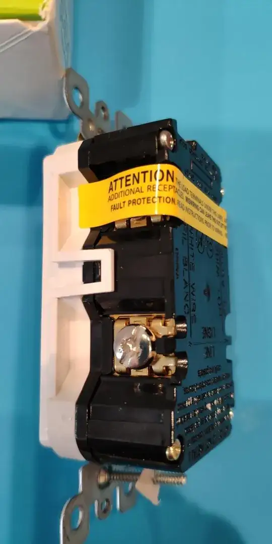

The reason for the label is that your GFCI won't work if you get it wrong.
LINE
This is the power incoming from the circuit breaker. This side must be hooked up correctly, regardless of the setup.
LOAD
This is the side with the tape over the terminals. This side connects to downstream outlets that need GFCI protection. It's common in, say, a new kitchen, that you have one GFCI protecting all the outlets on a given counter. Given how pricey GFCIs are (plus how they work) it's impractical to have multiple GFCIs in this sort of setup.
