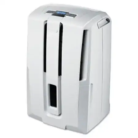

The simplist solution to dehumidifying in an area with no drain is to use a dehimidifier with a built in pump such as this one:
dehumid pump
It has a long thin tube that can be routed to an area with a drain (such as a washing machine drainpipe) or to the outside (through a window frame or a very small hole drilled through the wall). If to the outside, you need to direct it away from the foundation.
There are a few versions available and they tend to cost a good bit more than a simple tank type, but the convenience may make it worthwhile.
If you already have a good dehumidifier and don't want the expense of replacing it, you may be able to use an add-on dehumidifier pump such as this one
dehumid pump
It is hooked up to the demidifier and then uses a thin tube to move the water in the same manner as a pumping dehumidifier.
