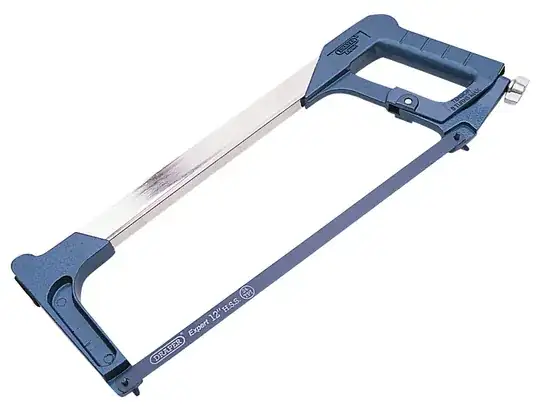

NOt as High Tech as Bib's answer but its still popular and only requires a bit of elbow grease.
A hand held hacksaw with a blade designed for steel.
TIPS
  • The blades sharp edges need to curve/point towards yourself (called a pull-cut orientation). So it will cut when you pull back. Otherwise you will have a really hard time doing this.
  • Apparently a push-cut orientated blade cuts easier as pointed out by AJMansfield
  • The blade should be tightly tensioned and if cutting for an extended time tighten it more when the blade heats up.
  • You can use a metal file to straighten out your edge.
