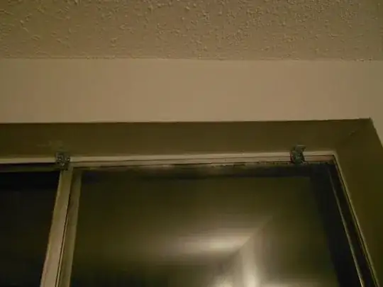

I've bought a pair of blinds that came with 1 1/4 inch screws; I'm unable to drill deep enough into the frame to fit the screws, the screws are sticking about 1/8 of a inch out . I end up hitting something pretty solid while drilling. Can I just go to the store and get slightly shorter screws?
The blinds are 69 inches long, and there's 3 brackets each with two screws, it probably weights 6-7 lbs at most.

From your pictures, the surface appears to be plasterboard (or less likely, plaster), which has to be attached to a support structure, either wood, steel or concrete.

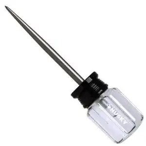

Wood To test if it is wood under the plaster/plasterboard, remove a screw and insert an awl until it just stops.
awl
With some force, try to push the awl in further. If it is wood, the awl should sink in a bit, but not too easily. There should be enough wood to allow you to drill into it and seat the screws fully. You probably need at least 1/2 inch of screw thread in wood for a safe hold on blinds. More is better. Remember that the plasterboard/plaster doesn't count. Try to guage how thick it is (probably either 3/8 or 1/2 inch) and add that to the depth into the wood.
Steel If the awl doesn't sink in, it may be a metal stud or a metal beam. If you hit something hard and the point can slide easily side to side, it is probably metal. Try to drill a small hole through it with a sharp drill bit. If it is a steel stud, you will be able to with a bit of pressure. You can then use a sheet metal screw to hold the bracket up. If it is a steel beam, you will not really be able to (it is too thick and hard). You will need a whole different mounting system.

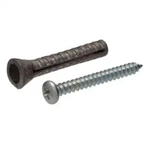

Concrete If the awl stops but can't be slid along a hard metal edge, it may be a concrete support structure. The awl should feel as if it is digging into something a bit gritty. You can mount into concrete but need to use a masonry anchor.
lead shields

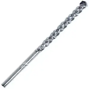

To insert the anchor, you first need to drill a properly sized hole with a special masonry drill bit.
masonry bit
It has a carbide insert in the tip. It is slow going and should be much harder than the plasterboard/plaster. The dust probably will be greyish or tan in color. Be sure not to drill a hole too close to another hole, or the concrete between them may crumble. You then need to insert the anchor and screw the bracket into it.
