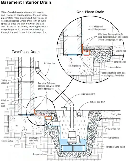

Instead of redoing what's there, we are having a Sure-Dry system (affiliated with Badger Basement but cheaper) put in along the inside perimeter. They remove cement, lay this perforated piece that looks like rain gutter almost, but has a high back on it. The back will go along the basement wall to catch any water that may run down the walls as well as any water that would normally come in at the floor along the wall. It goes to their sump pump and will head far out into the backyard.

Your (what I call) interior footer drain will certainly help, but you're at the mercy of the drains always remaining unclogged and the sump pump always having power. You'll also have to make sure it can handle excessive rain during those big midwestern downpours.

The internal drains will stop seepage from coming in. It will not safeguard against moisture, humidity, or condensation. EVERY basement waterproofing company will state that in their contract. Mine does.
To address Herrbag's comment:
"How does this system address sloping the drain to a sump? It appears that the 'drain tile' sits in a fixed position above the footer, meaning its level... – HerrBag"
You are observant. That's why when you need French drains installed, you always want a company who installs perforated PVC pipe AND pitches the pipe down to the sump.
