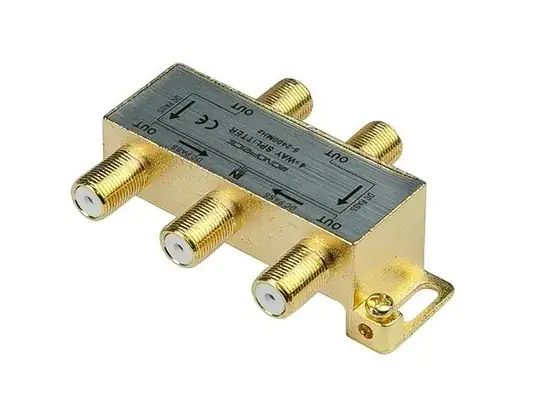

I assume there should be some sort of splitter somewhere.
Something like this: enter image description here
So to test the cable you can move the suspect cable from one of the splitter outputs temporarily onto one of the outputs that you know works. Now plug a TV into it that you know for sure is working and see if you get signal. If not then there is something wrong with the cable, or the connections to the cable.
It could also be the splitter, so trying different output combinations may help you diagnose where the problem is.
