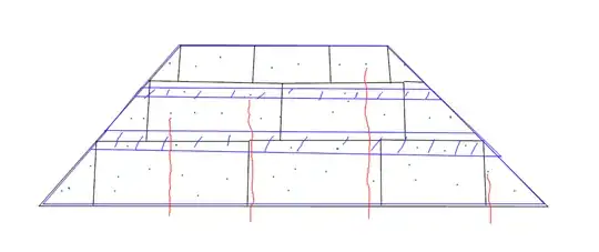

Here is a very vague and disproportionate drawing of what I tried to explain:
  • black lines represent OSBs
  • blue lines represent the membrane which is laid out in 3 rows which overlap at the ends
  • green dots represent staples, which are all over the place
  • red represents where water is supposedly entering and reaching the OSBs, then continues on to drain to the end of the roof on top of the OSB and below the membrane.

If you were in the US, I would say "install the roofing," but I'm unfamiliar with European standards for OSB. I see "water resistant binders" associated with OSB3, so that's probably the same stuff that we use for roof paneling in the US (listed as "Exposure 1" grade). I saw an APA conformance document indicating that US suppliers ship to Europe, and I perceive that as corroboration.
Your subroof assembly can dry to the interior, so an installed roof will be a net good. You might place a fan in the attic to accelerate drying (removing the moist air as the water evaporates from the underside of the OSB). With only one panel face for the water to diffuse out of, I expect that it will take about twice as long to dry (twice as long versus a simplified model of the alternative case with no sun and no moisture barrier to maintain high humidity beside the top surface).
The barrier is punctured all over the place, so obviously it's imperfect, but if the shingles handle 99.5% of rain and snow, then 80% effectiveness from the barrier still takes that 99.5% up to 99.9%. Your 90% sounds pretty good to me, but that's just the personal feelings of an idiot on the subject.
For OSB rot, the problem is from persistently high moisture content, not a one time deal during construction.
