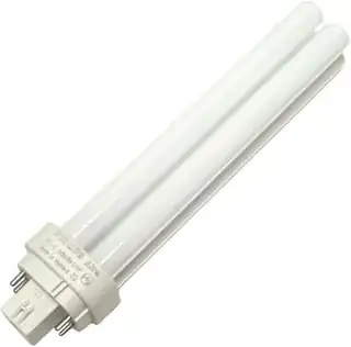

then it is a compact fluorescent or CFL. There are also some others, such as this 4-pin CFL from Amazon:
4-pin cfl
If it doesn't look like one of those, then you may have a regular fluorescent bulb with a separate ballast, which would require rewiring, etc.

If you replace the socket with an Edison, you have to mount it securely as well as wire it, and you won't know if you have enough light until you've done all that. Given the 4 pin socket and the presumed age of the fan motor, I would recommend replacing the whole unit and be done with it. (If you get one with an Edison socket, you can easily increase the light level as needed, assuming the enclosure is so rated.)
