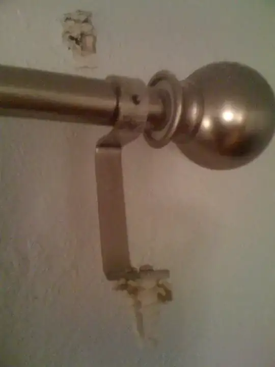

My children managed to pull on the curtains hard enough to yank the bracket which attached the curtain rod to the wall out. What is the best way to repair this?
Here's what it looks like: here's

There's several ways to fix this, depending on a few things.
The best thing to do is avoid drywall anchors, and screw directly into a stud. If there's one close enough that it looks okay, you should do that. You'll have to patch up these holes, which may be a bit of a pain to do with the textured walls, but it's doable.

It's hard to tell from the picture, but if the curtain hardware doesn't totally cover the holes you'll need to do some cosmetic work. Keep in mind though that if you patch these holes with compound, they still won't be as strong as regular drywall, so you won't be able to put the same size anchor back in and expect it to hold.

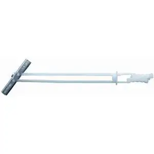

Another alternative to the standard toggle bolt is Snaptoggle bolt. It will stay in place if you remove the bolt. The only disadvantage is it should not be used if the area behind the wall is uneven.
