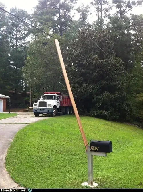

This person used external guy wires:
(NOT A RECOMMENDED SOLUTION!)
A relatively quick and cheap fix is to drive a steel angle down beside the post and lash it with bailing wire. It's not particularly pretty.
