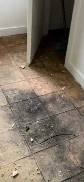

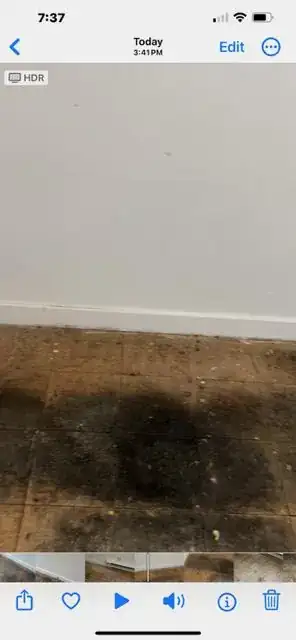

 second picpic of floor3So I decided to remove old gross carpet from a bedroom we haven't used yet so I can start using it and discovered that there was a lot of black mold under it. I am assuming previous people either had a leak or spilled water and didn't deal with it. Under the carpet is old cracked tile flooring, so I decided to remove that because that is where the mold is. Problem is it's so stuck to the floor took me half hour to get 6 tiles off.
I used a chisel and tried to get under the tile. I also tried heating them up with an iron. left it there for 3 minutes, didnt help. Some broke and came off in bits. These are thick tiles, not sure what they are made of, but they don't seem to be peel and stick because there is a lot of glue under there. Most of the tiled are cracked. I am wearing gloves and face mask. there must be a better way so I am not here doing this for months.

With a plywood subfloor, it is a dirty, tiring, time consuming job to chisel all the tile off the floor. Then you have horribly damaged plywood that may have to be removed as well if not at least covered over with another thin layer.
Do yourself a favor and consider covering the tile with a solid core vinyl product like LVP or LVT.
You may only need to clean the mildew from a small area and pour some leveling compound to even out the area you already removed tiles.
This would be less time, less money.
Update: Since the pictures have been posted, it may be an old tile that contained asbestos. Have it tested first. The result will determine the next course of action.
